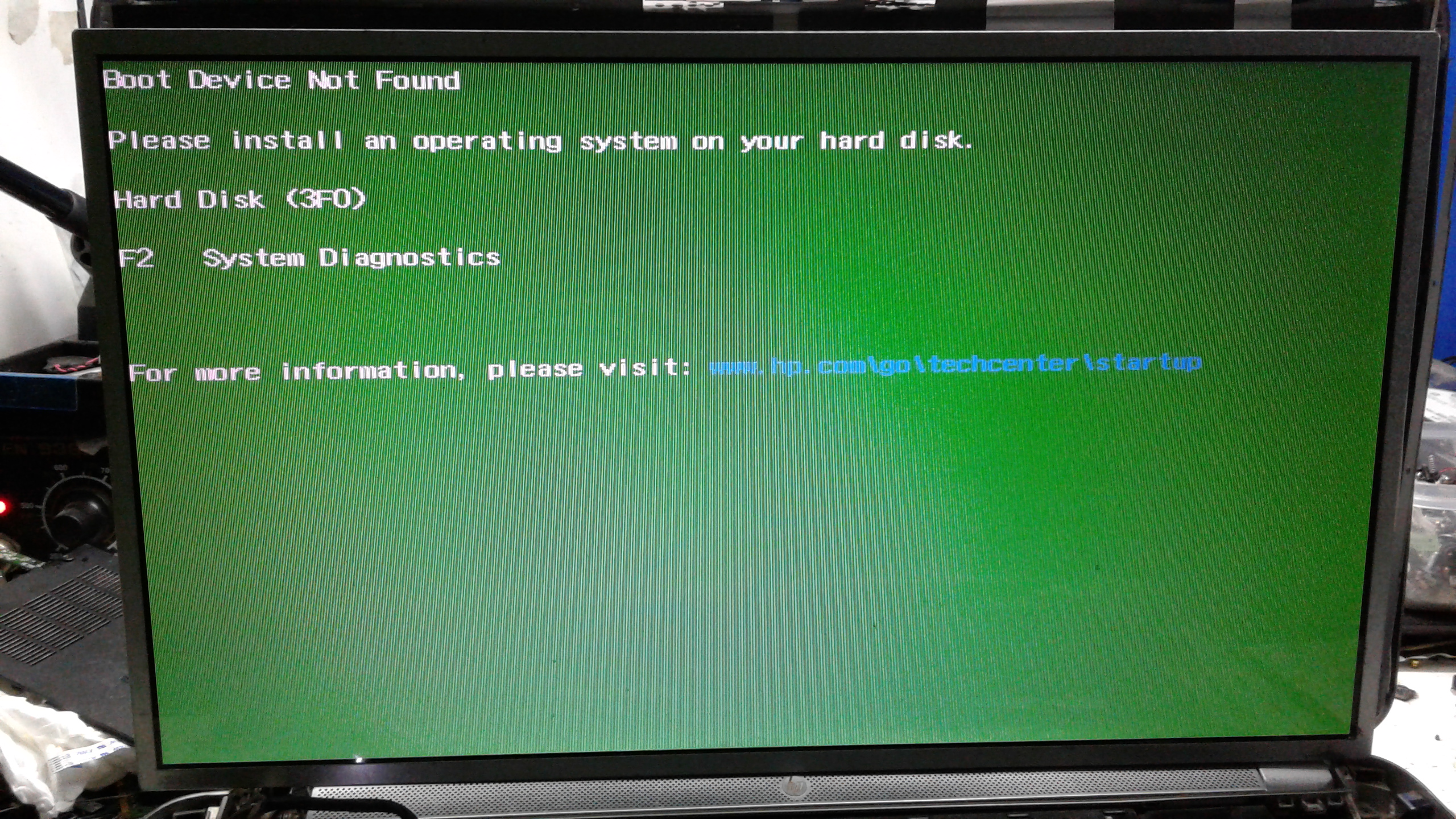

hp dv7 green display with grains
anil999
Posts: 149
Joined: Tue Nov 22, 2016 2:17 pm
Location: Dubai
Post by anil999 »
PCB HPMH-41-AB6200-E00G
PWA: HPMH-40GAB 00-E
Change display same result
change cable same result
graphics conversion DIS-UMA done, same result
any idea friends?

Check lvds connector in mb for dry sold or change it

im have same problem reballing bga and ok!

please press ctrl+d and press power buttom...first laptop off and ctrl+d and press power buttom.
