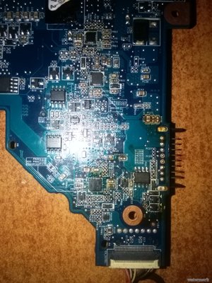

Hi every body
model: Hp pavilion dv6
part number: hpmh-41-ab6300-d00g
at first it won't turn on with adaptor, checking found power source mosfet not working, change that
now computer turn on with adaptor and display come, the problem is here that it won't charge the battery
and it wont turn on with battery
solution please

Plz tell me the led on dc connecter come a light and any change on battery put led color change if blink or other plz check switch voltage to mosfit and in battery wat system say battery dection
Re: hp dv6 won't turn on with battery and won't charge the battery
Please update battery cannector voltage with battery and without battery
there is not any led and led blinking when battery is connected
and when connect to dc power supply no amps
in first positive battery connector pin I've just 2volt
and when I connect to adapter and 3.3v in all pins (smbdata,smbclock...)
and when I unplug the adapter and battery is plugged no 3.3 volts are available

replace super i/o controller

your replace the bad p ch mosfet with n ch mosfet
