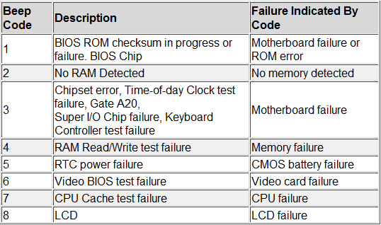

Check image
Dell beep codes.png (18.41 KiB) Viewed 3156 times
