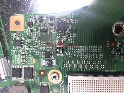

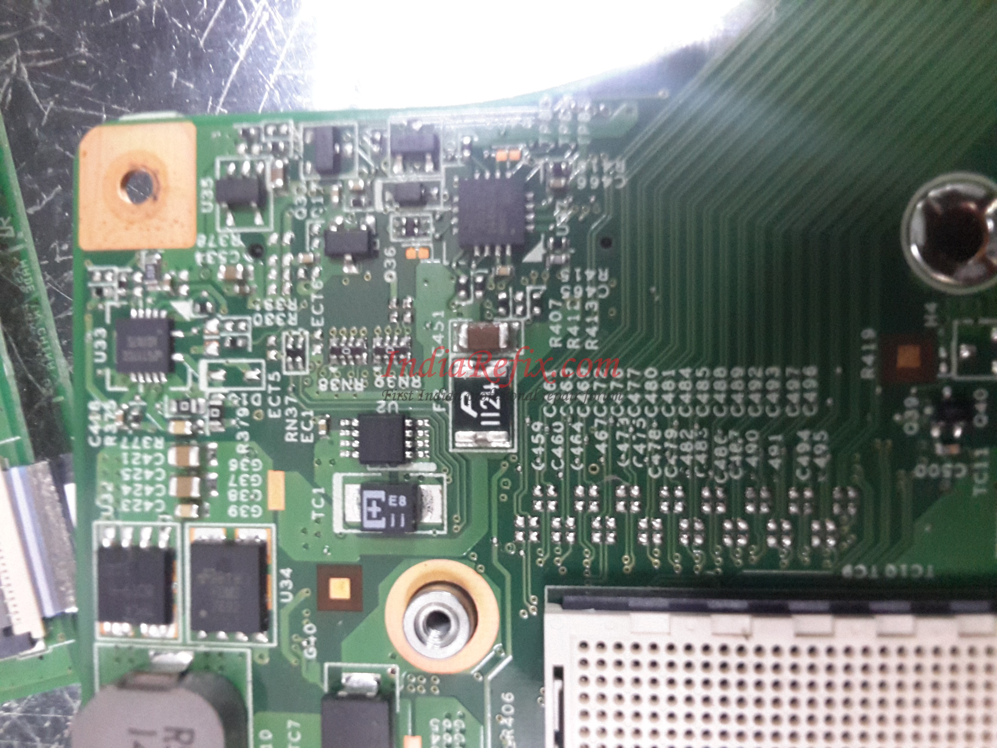

In motherboard lvds f2(fuse) is getting heated
Please help

Seems leakage capacitor shows 12ohms

first chk display cable for burn internally bcoz main power of lcd 7v to 21v supply shorting.may be problem solve

Problem solved 1 cap shorted near lvds fuse
