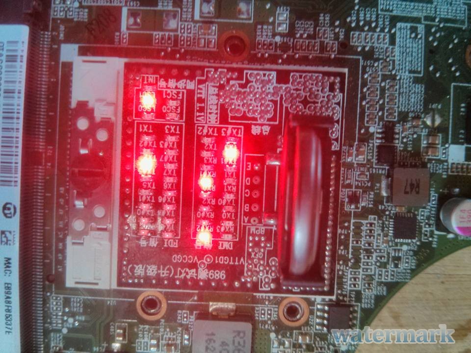

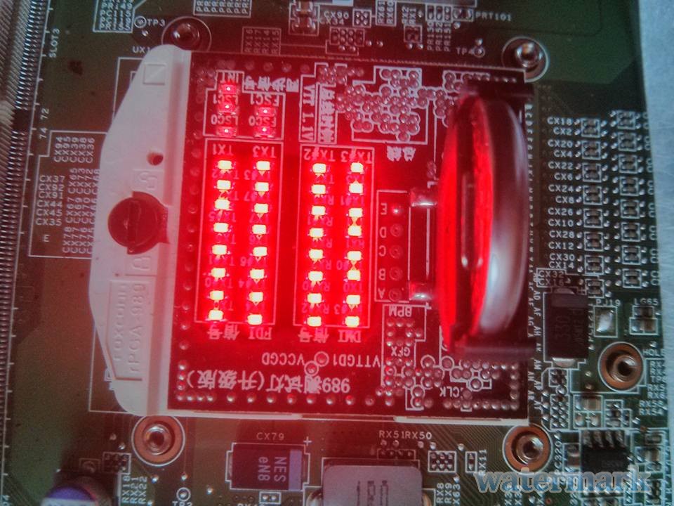

Will try replace pch
Bad VS good cpu socket tester

I am 100% sure this is not repairable now. :p

its pch either cpu socket, Kamal :)
