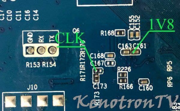

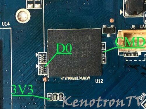

CV538H-Q50
eMMC
EMMC PIN OUT CV538H-Q50
- CV538H-Q50 1.jpg (35.89 KiB) Viewed 1678 times
- CV538H-Q50.jpg (35.07 KiB) Viewed 1678 times
