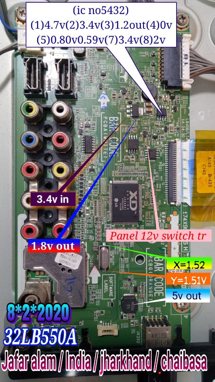

LG LB45B LT45B EAX65550504 (1.1) MAINBOARD SUPPLY DETAIL
- LB45B LT45B.jpg (181.74 KiB) Viewed 2174 times
