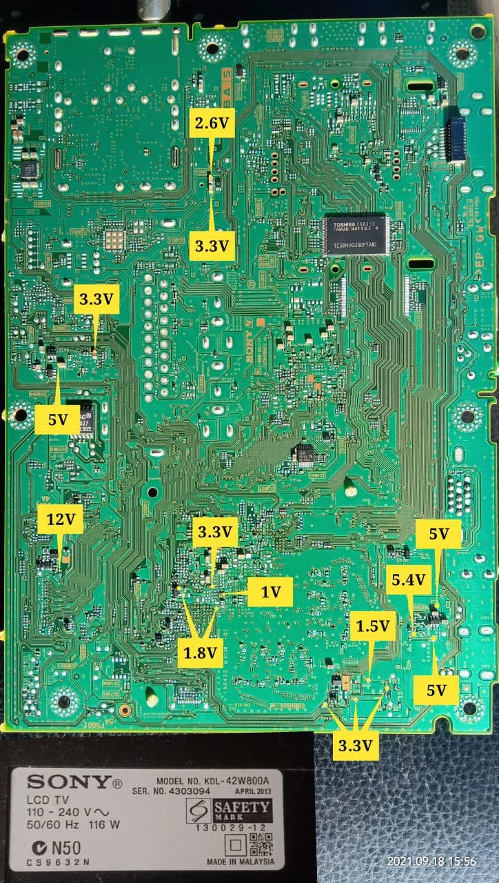

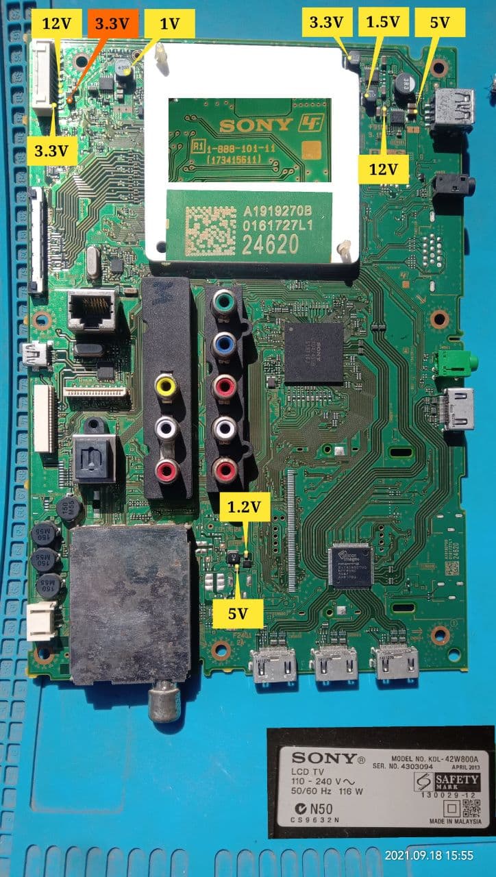

SONY KDL46W700A A1919270B 1-888-101-11 SUPPLY VOLTAGE DETAIL
- KDL-42W801A.jpg (223.87 KiB) Viewed 1692 times
- KDL-42W801A b.jpg (164.98 KiB) Viewed 1692 times
