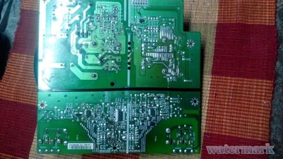

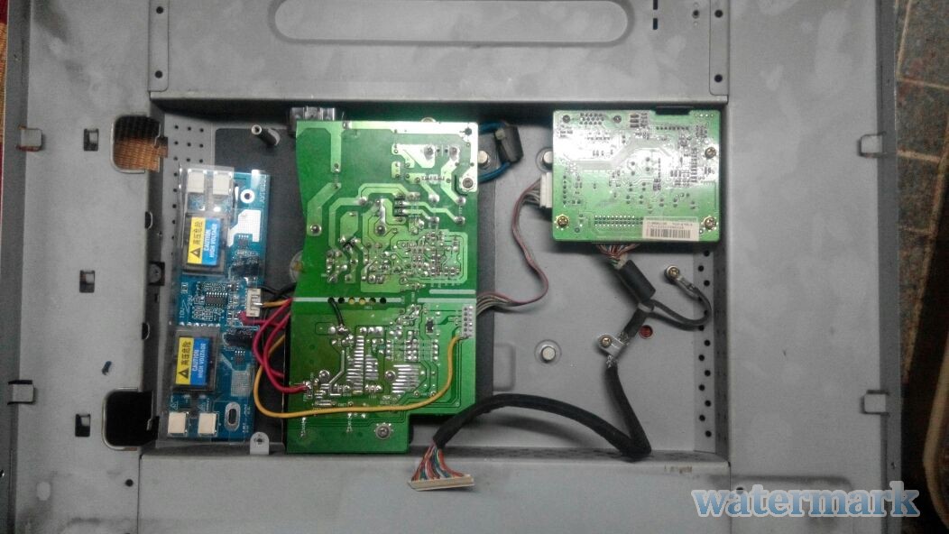

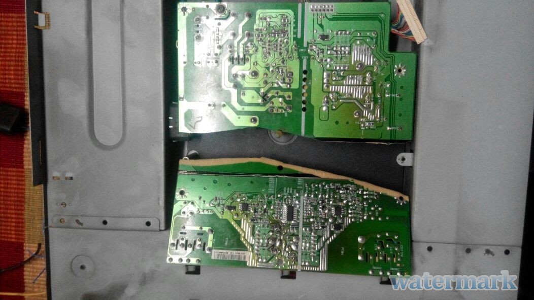

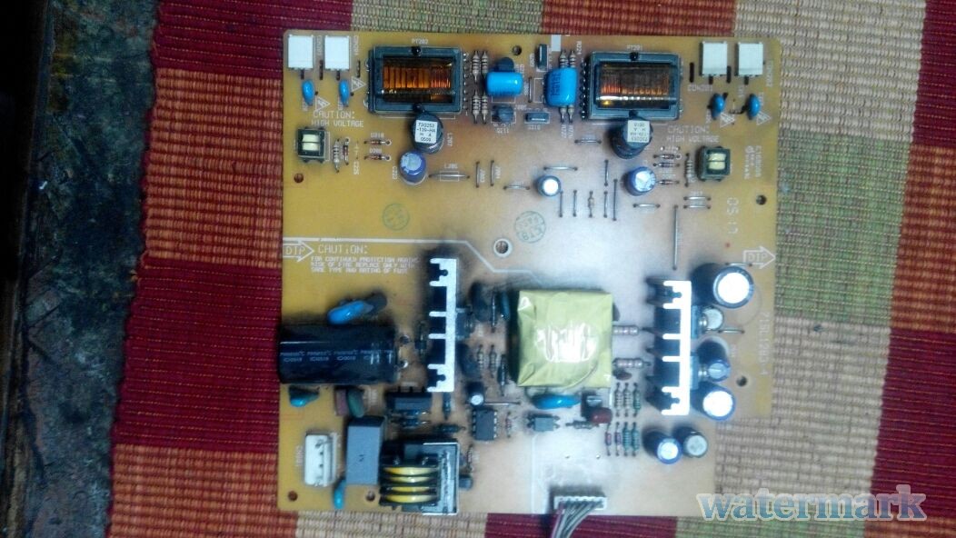

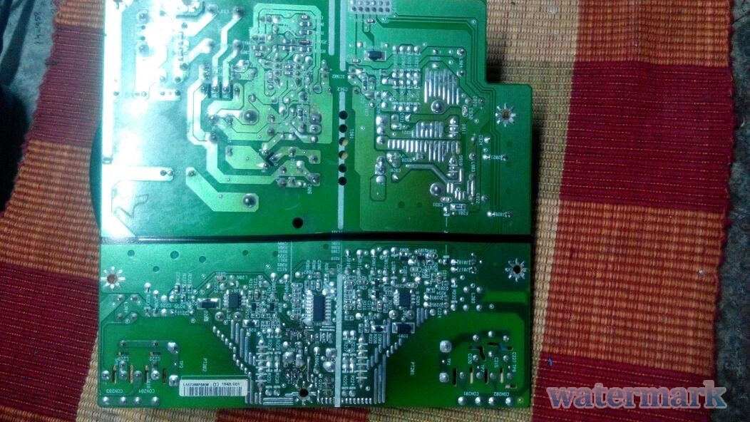

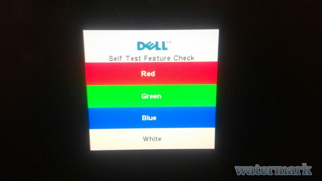

case study :dell old model lcd e193fpc dim display.
fl section faulty. npn transistor and transformer both faulty. no arrangement for components. no space for universal fl. so cut fl section PCB and put universal fl lcd working fine pics.[glow=red][/glow]
