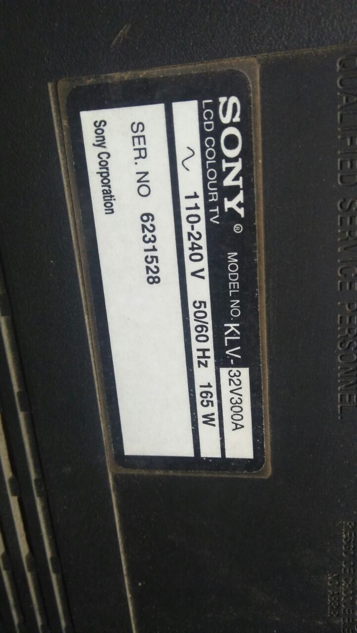

Brand : Sony
Model : KLV-32V300A 5 Blink
Panle : AUO 315XW02 VE
Problem reported : 5 blink

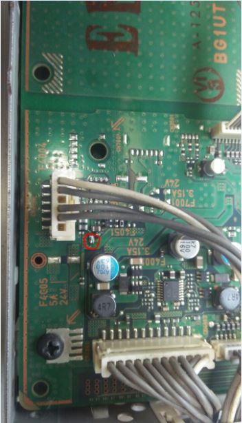

As per Sony self test its Panel Related Issue , when we measure supply on T-Con Board 12v supply is missing so i am trace back track , found mosfet but their also supply not available again check to back track then found 1 SMD fuse open put thin wire then check all supply ok now set working ok
