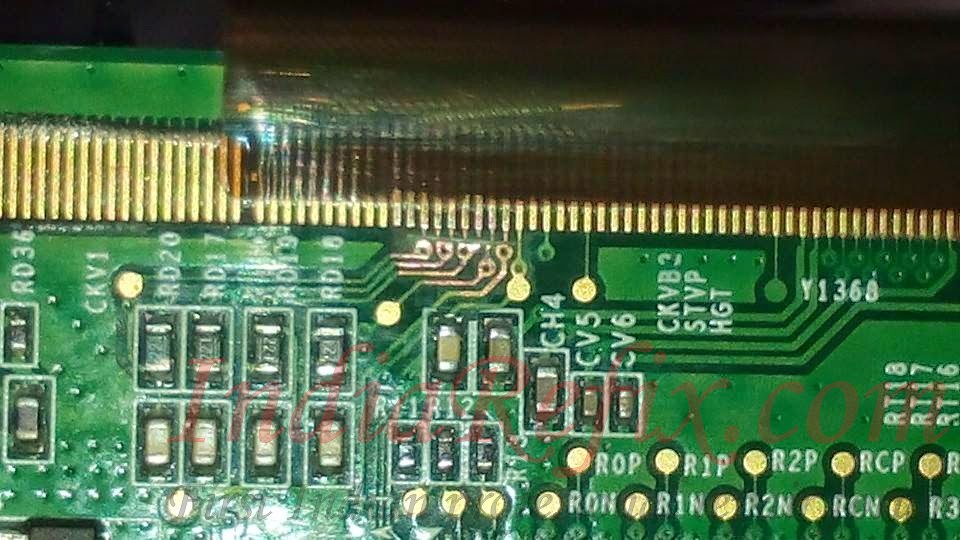

SAMSUNG LED TV 32" SERIES WITH DOUBLE IMAGE PROBLEM
If you find lcd/led tv with double image problem , some time with jittering... maybe full screen or partial.U can try to cut CKV1,CKV2,CKVB1,CKVB2,STVP,VSS right side..or left side depending where the problem come from.. left gate driver problem.. or right gate driver problem...but this is not guaranted solution..depending on glass panel type and source of problem... be careful on procces.
