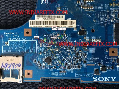

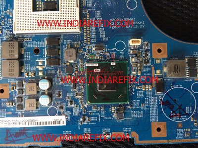

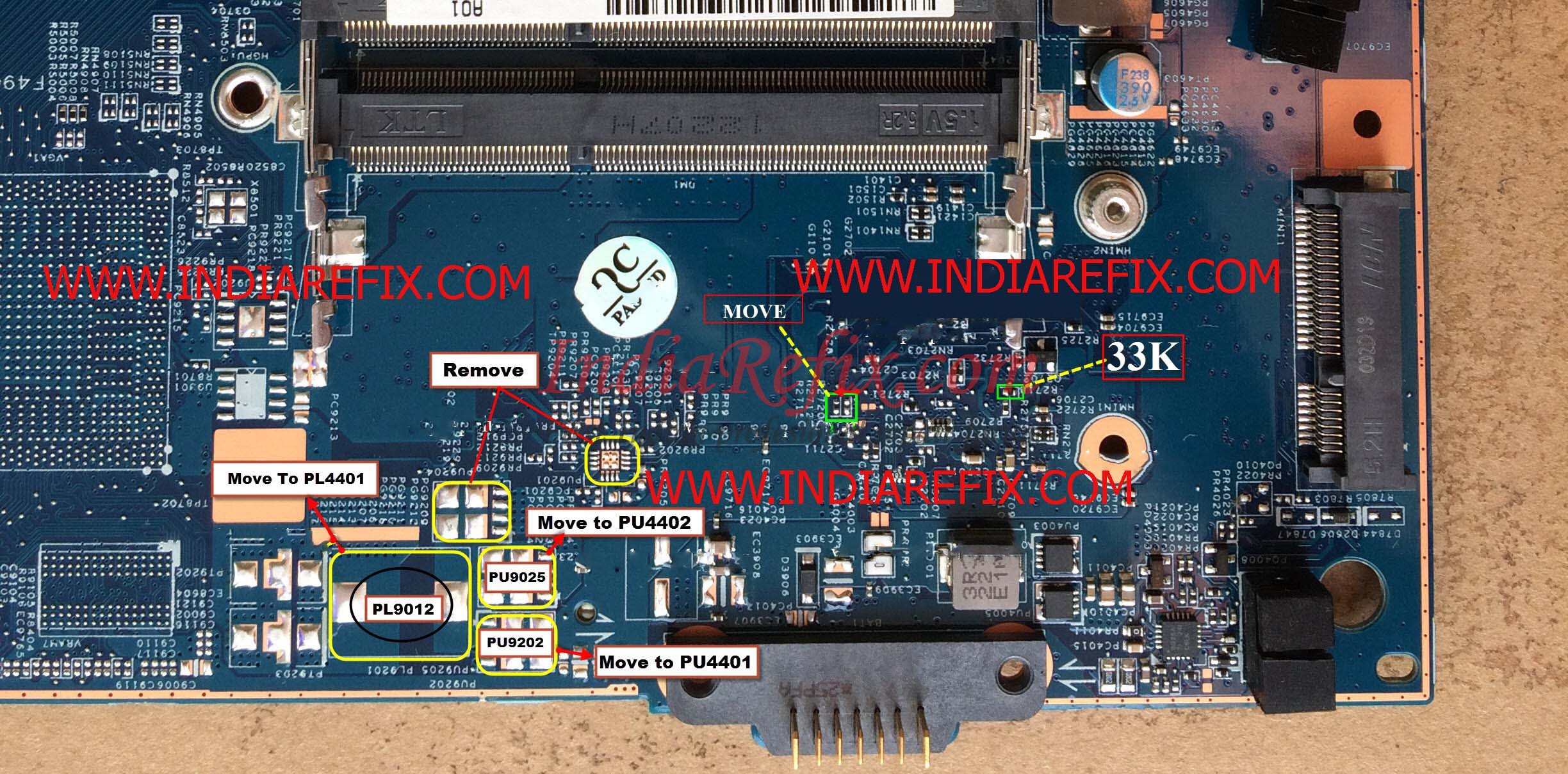

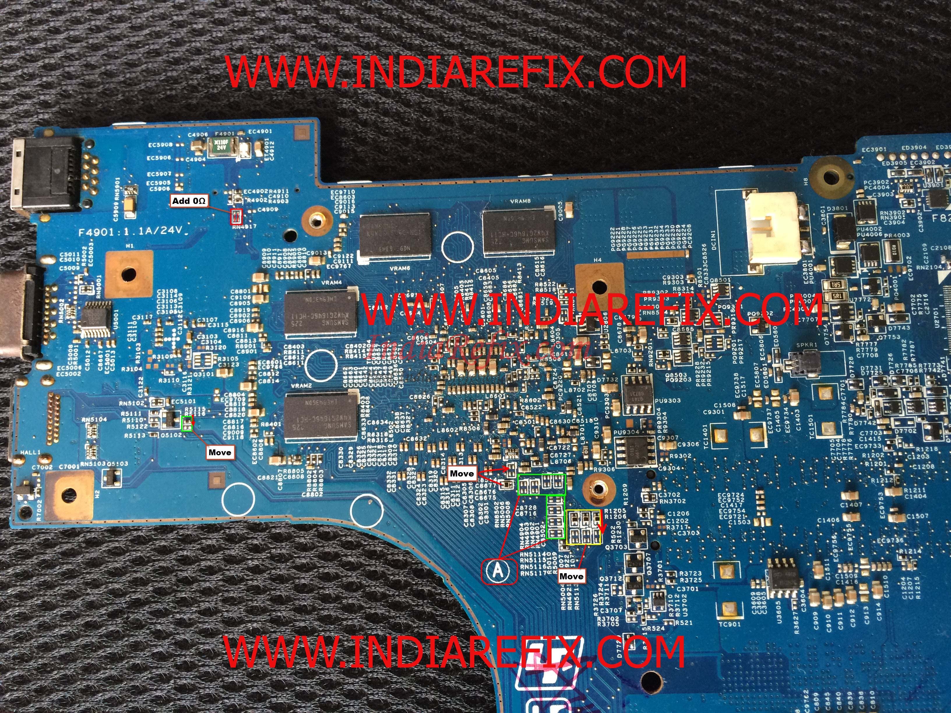

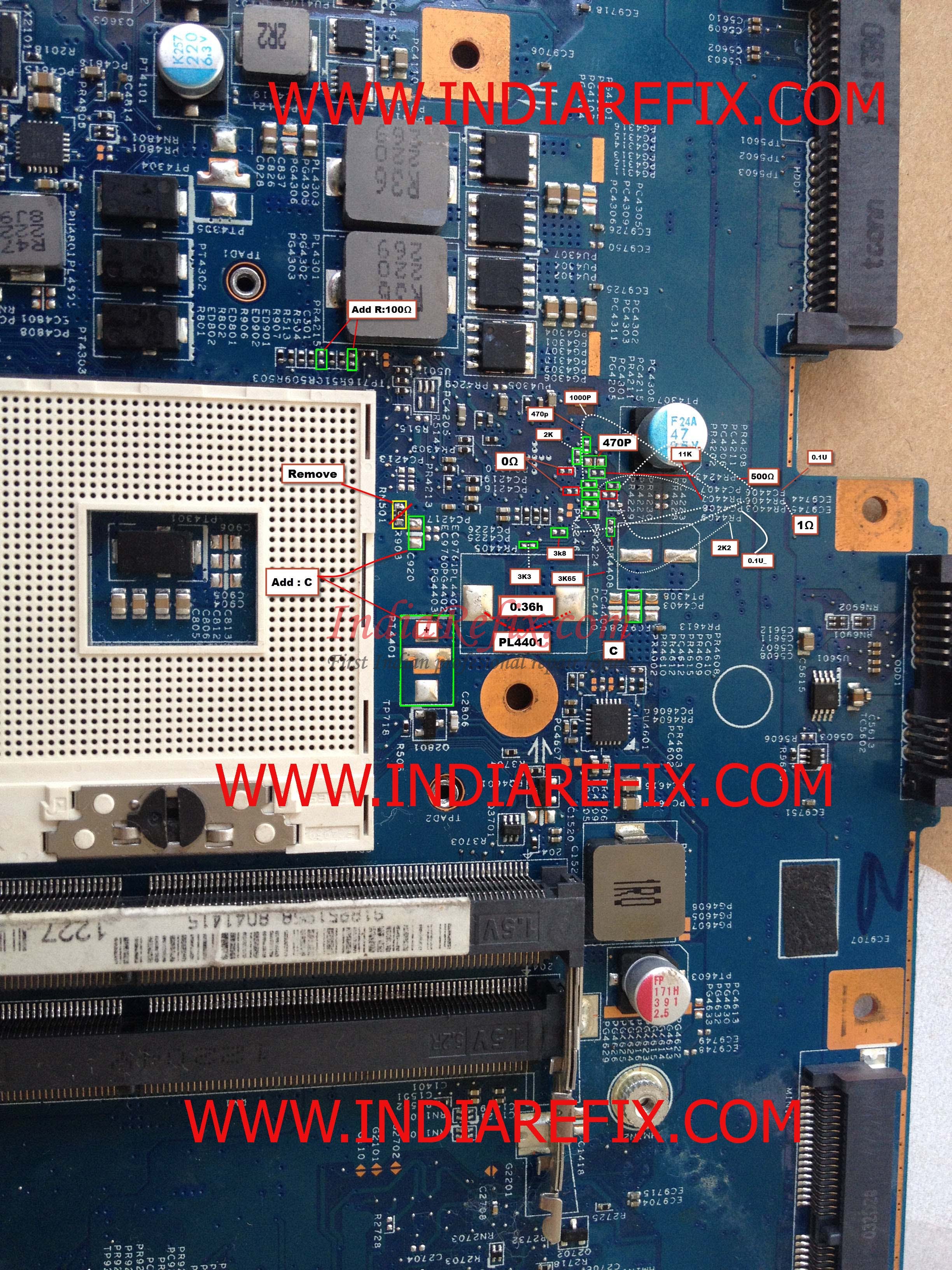

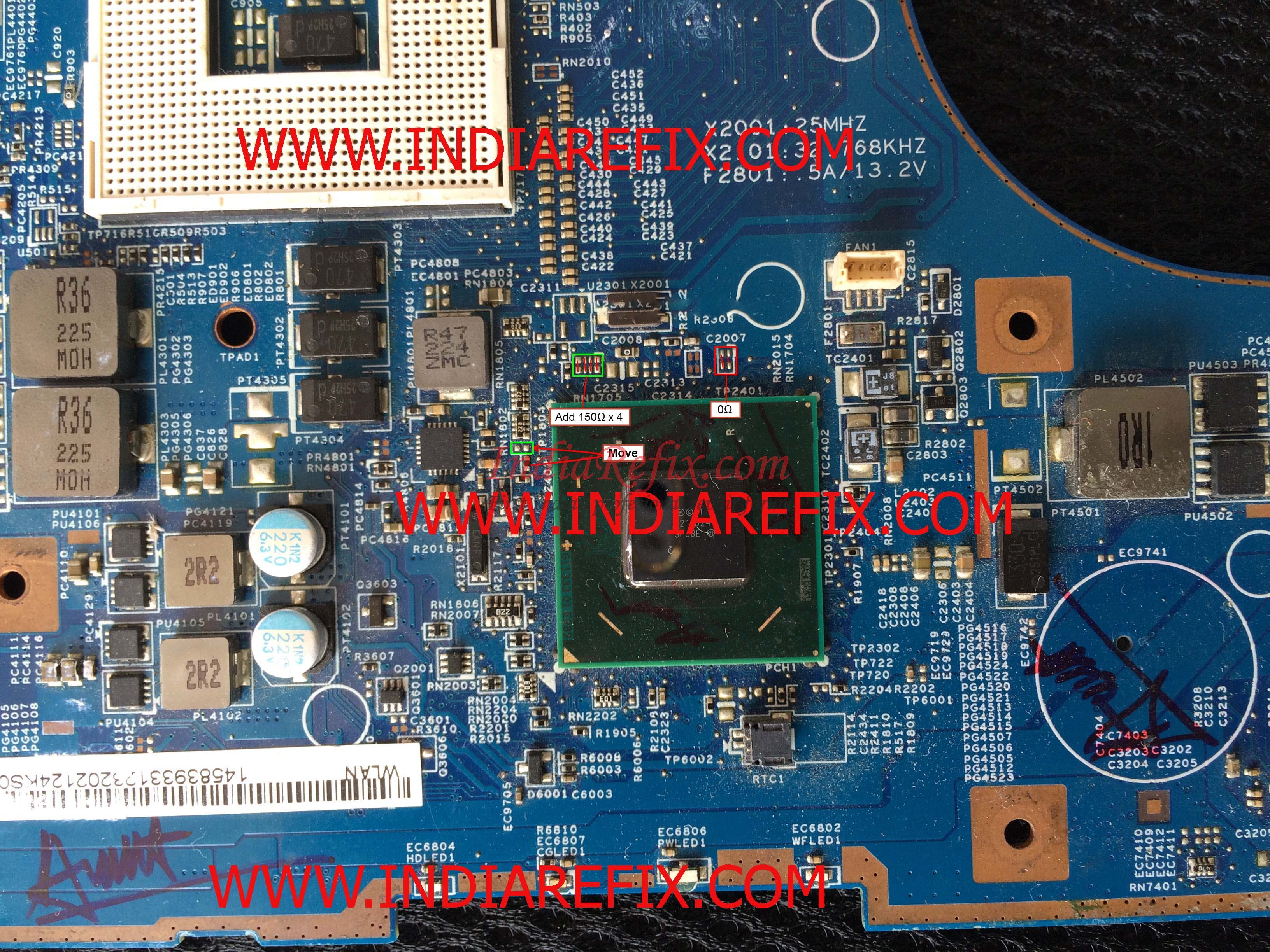

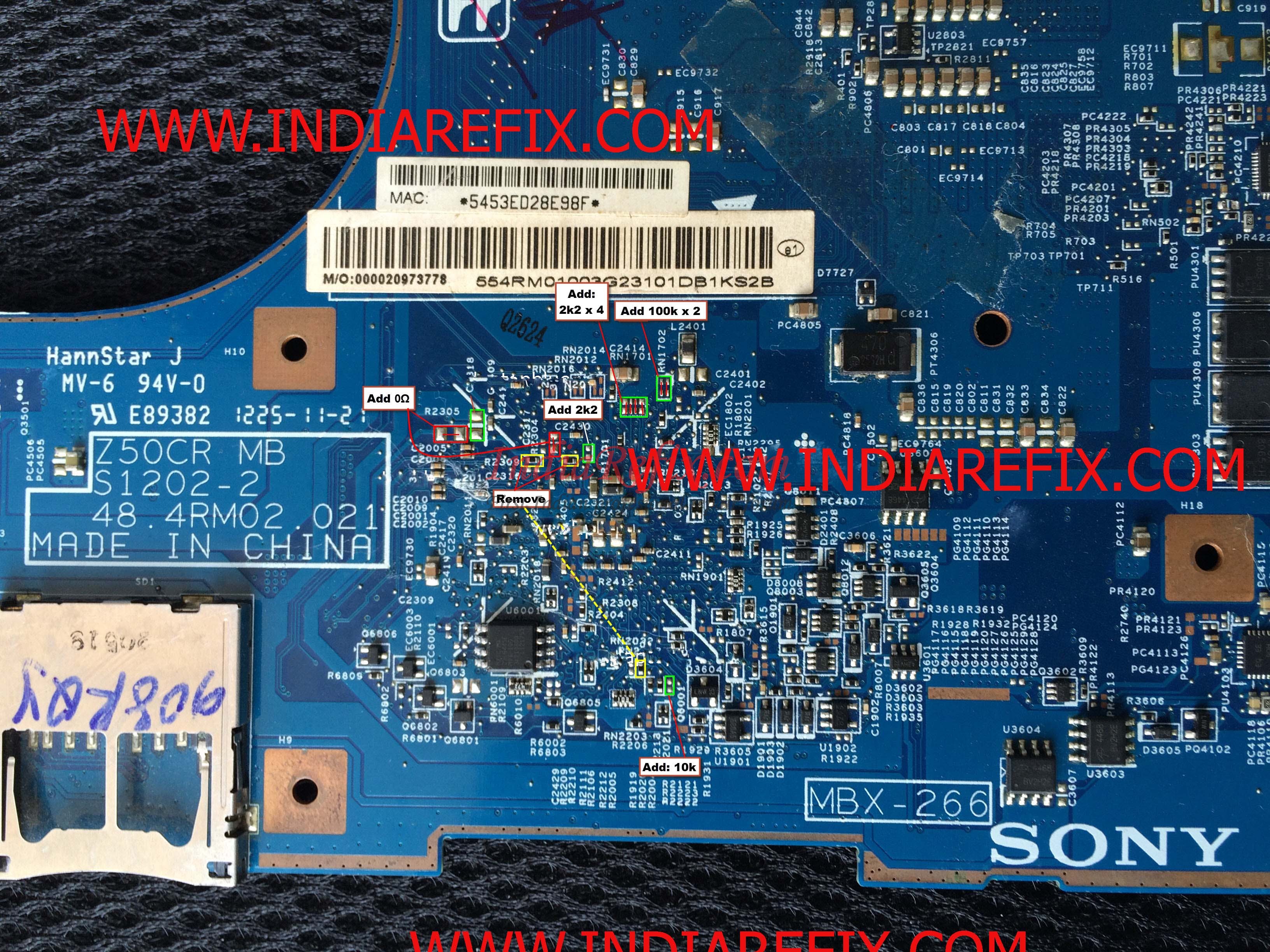

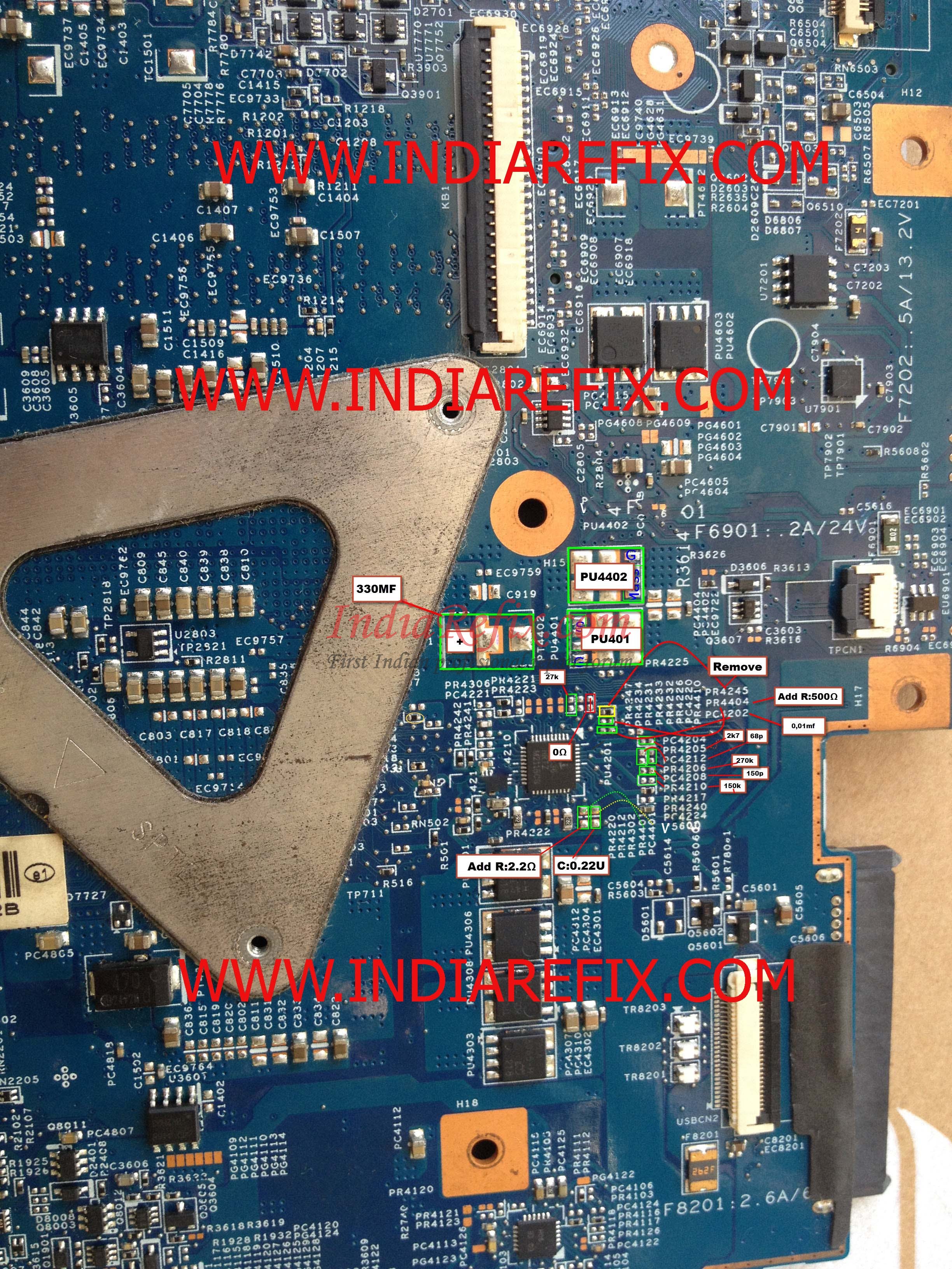

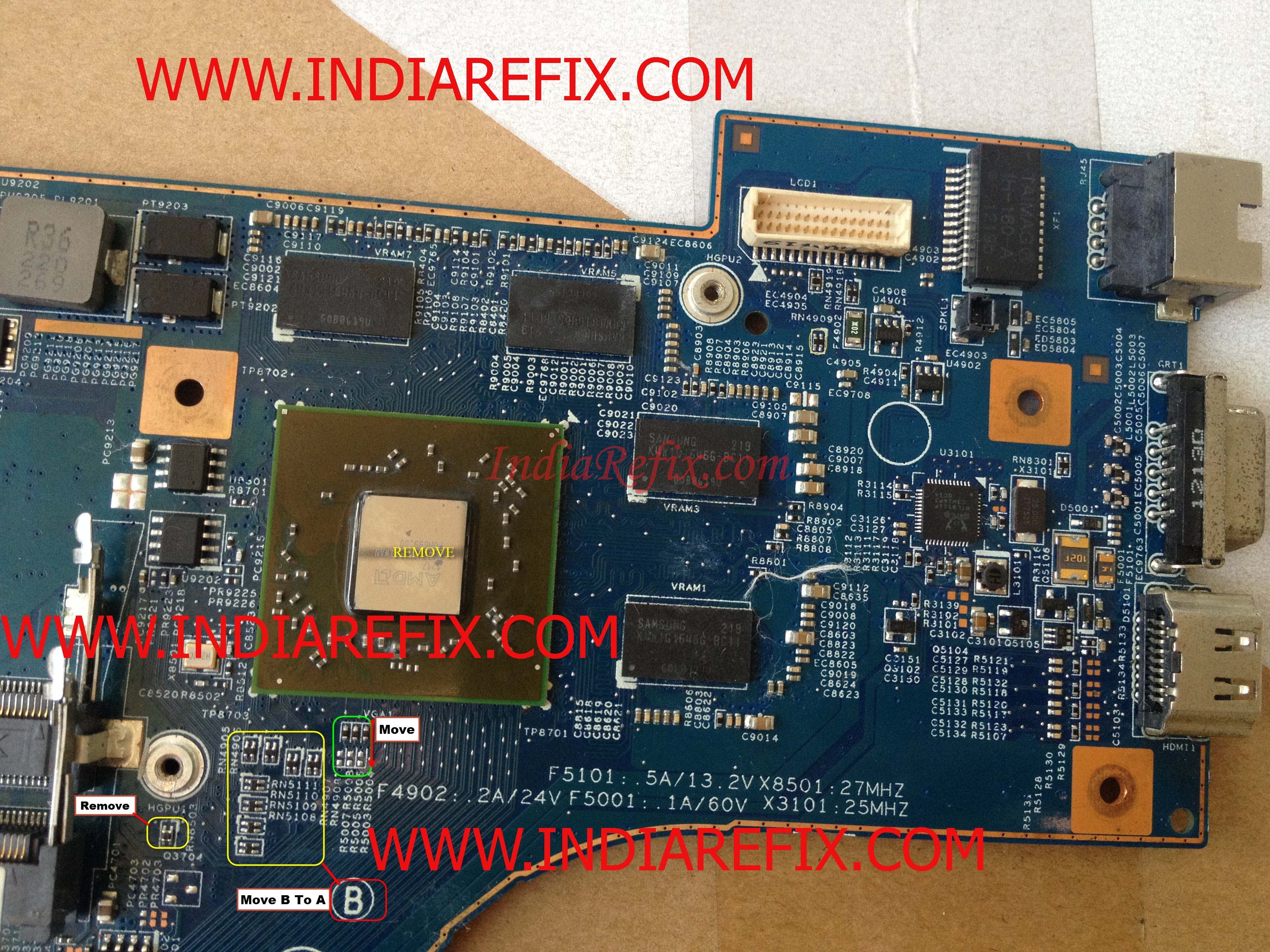

This is Final Solution mbx-266 To convert It to UMA Mode. This is not my data, its provided By my Freind Mr. Domas. Say thanks to him. :)
