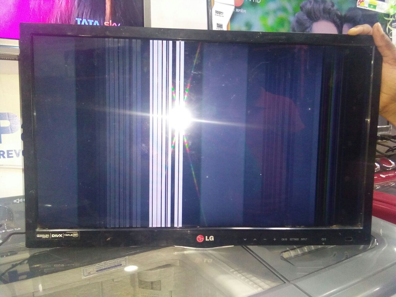

Problem Reported : no-picture Only Vertical Bar in Screen

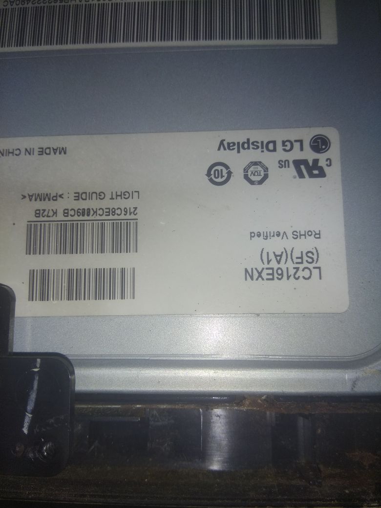

Its Panel Related Issue

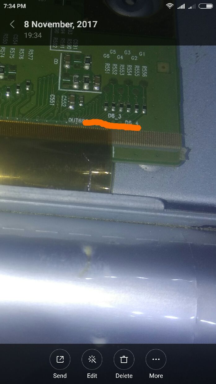

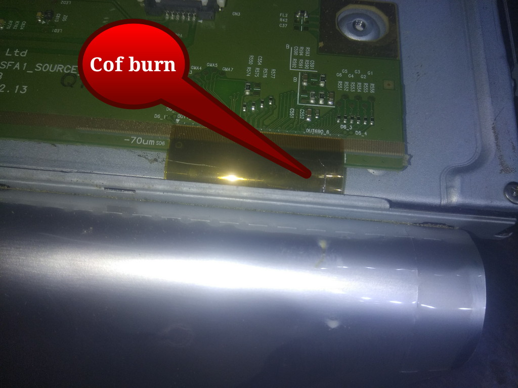

Diagnose : Found Source Cof Burn
Solution : Cut Few Track ( Power related ) With Sharp Blade Now set Working ok
LG22LN4055 Vertical Bar
